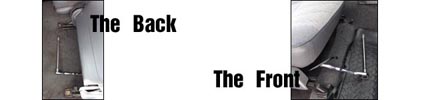

First off, just remove the four bolts that hold each seat in place. Next, gather any loose change you have because fuel is so expensive. Then vacuum everything up that you might find underneath the old seats. The new seats are higher up off of the floor than the old ones so you will be able to see underneath them and even store more stuff under them.
0407_comparo_lined.jpgOnce everything is all cleaned out it's time to mount the brackets to the racing seats. First pull the bracket out of it's packaging and make sure the sliders are in the correct position and that the mounting holes that mount to the floor are a little bigger than the bolts themselves. This leaves a little slack just in case your floorboards have a little slack in them from years of use. I drilled mine out quite a bit. Then you need four bolts to mount each bracket to the bottom of each seat. Now I HIGHLY recommend testing out the slider adjustment on each seat bracket assembly. You don't want to bolt in the seats all nice and tight only to discover the seat sliders aren't working as well as you would like them.
